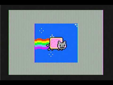

This project archive includes the Nyan Cat top level program, a basic 8 bit per pixel graphics library, and a slightly modified 8 bit per pixel driver, authored by Eric Ball. I really like this driver! Color generation is done via software wave generation, synced perfectly to the pixels, allowing stable artifact color on NTSC.
You can see some of his other excellent driver work here: http://forums.parallax.com/entry.php?104-Links-to-Propeller-stuff-I-ve-done Be sure and send him a note, if you use the driver cores he's produced. We've got a lot of interesting color methods and signal options because of that. (thank you)
Right now, the graphics library includes the core things needed to make use of the screen. Pixel plot, fill area, clear screen, bitplot (move image from RAM to screen with transparency)
The graphics animation and library are being ported to C. I'm actually very interested in how things will perform. There are a fair number of VGA 8 bpp graphics functions out there. These could prove very useful in C, depending.
I've a line function in Spin that is in the process of being ported to PASM.
All graphics functions are RAW with no clipping, etc... You need to bounds check, clip, etc...
A single display buffer is used. Was doing some graphics on my Color Computer 3, which also has a nice artifact color 8 bit per pixel mode, not unlike what this driver produces, and it has only bitmap graphics. The same techniques apply here on the Propeller, but with a lot more speed! The TV COG sends blanking signals to other COGs so synchronized screen drawing can occur. 0 = bottom of screen, in blanking period. The screen isn't visible at this time. 1 = start of active graphics odd frame, 2 = start of active graphics even frame. Video output is interlaced NTSC, composite.
The main loop waits for the bottom of screen blanking signal, then rapidly clears the display buffer, followed by the current state of the animation. This animation consumes about 70 percent of the draw capability at 80Mhz.
[video=youtube_share;0yLOoOhG1LI]
Enjoy! Any and all comments welcome.
Display issue reported, and fixed. Release version with Ahle2 Retronitus sound attached to this post.
It's not hard to adjust the cat speed now. Modify to suit your taste. (in main).

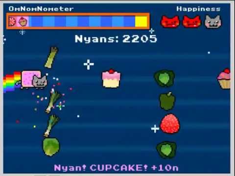

    @potatohead
    How about making a nyan cat game?
    /Johannes
    edited 2011-12-01 13:35
    I'm totally up for that.
    What would the game be? Avoid the Xmos / Pic / Avr / etc... chips, and get the Props for points?
  • Ahle2Ahle2 Posts: 1,179
    edited 2011-12-02 12:26
    Something like
    But with microcontrollers?!
    edited 2011-12-02 12:45
    Too funny! I have a suspicion that, even though he gets plenty of exercise, Nyan Cat will never be the spokeskitty for this website: http://www.letsmove.gov/ :)

    hate to be a wet blanket, but some of the colors dip into _sync_ land where it causes my CRT television to lose horizontal sync for certain pixel lines.
    I feel that the gray background i see in the code was maybe a hack to get a video capture card to not mess up?
    For me right now the pixel lines of the top of the "tart" and the paws of the cat is where there is no horizontal stability.
    I can remember seeing the same sort of "bowing to the right" of the lines in the wolfenstein raycast demo and on the title screen for the block moving game "unterwelt?" in its name (man I miss all of the old posts).
    This is a postmodern CRT television, one of the few good TV's APEX ever stamped their name on. I like using this TV as a benchmark, because it still uses a lot of analog processing and it does like to follow the NTSC standard with little margin for bad timing.
    edited 2011-12-02 20:24
    Unfortunately, to get fully-saturated composite colors from the Prop, the lower chroma tips have to dip into "sync land." This is because the Prop's composite chroma output can only twiddle the gray level +/-1. For maximum saturation, this means twiddling from maximum to maximum + 1 (i.e. overflowing to 0 or sync level). Non-saturated colors tend to be a bit washed out, and a pure yellow, for example, simply does not exist in the normal color gamut.
  • whickerwhicker Posts: 749
    edited 2011-12-02 20:47
    Well, I was more concerned about all of the $00 's in the bitmap section.
    In fact, if I highlight the code between the label "catsize" (line 253) and the comment "'Starfield animation data, position 12 off screen" (line 467)
    and then select Edit->Find/Replace, and replace all within that range of $00 with $11, it works fine.
    To me, I think the long horizontal lines of $00 make it seem to the TV that it is a sync pulse?
    edited 2011-12-02 22:57
    I ran the grey for some color fringing I saw on the blue box. Didn't think about the sync issue at the time. All my devices displayed it nicely enough.
    On high color contrasts, this driver can create "ghost" colors, and the grey minimized the impact of that. This code was developed on an 80's era TV. Normally I use a capture, and would probably have seen this. I did one capture session after solidifying the display. My good card won't typically break down on that, (ADS HDTV USB) but the "EZ CAPTURE" one absolutely will. (I think it's a lot like your TV)
    In the end, I liked the grey, so that's why it's there. :)
    That said, I've not really tested all aspects of this driver. It uses some techniques new to me, and I ran it largely as is. Looks like a test 'n tweak cycle is warranted.
    No worries here. Glad you mentioned it.
    I like it because it generates it's own color burst that is always in phase with the pixels, making the artifact colors seen possible. I suspect the 4 color pixels in the active display include a sync, not black level. Probably an easy change.
    "catsize" has two bytes that detail the x and y size of the image data to follow in pixels.
    The function "bitplot" will read those two bytes, then draw all the pixels to follow according to those sizes, at a given screen buffer position, and will not draw one designated color in particular, so that other objects can be seen through.
    The $00 in the image data is simply mapped to one of the four active display colors. The remaining color values do not map to the usual Propeller colors, because the means of color generation does not use the internal color phase generator. That also means the horizontal pixel size of this particular driver is fixed at the resolution seen here, just FYI.
    edited 2011-12-03 00:01
    Yep. Sync level one is in the active area. Very easy fix. I think this is just a typo, or oversight. Make that edit to the 02 driver, or go to top post and use the 03 driver code contained in the finished archive.
    dactive                   LONG     $7755_3311   *was*
    dactive                   LONG     $7755_33[B]22[/B]  *is*
    I'll correct the one with the sound integrated, set for a black background, just to be sure, and put it up here in a few minutes! And that did cut down on the fringing I was seeing too. Still there, but at levels I think are just how this method of color is.
    So it's two fixes in one. Nice catch Whicker! :) Appreciated.
    To be perfectly clear, with this edit, the value $00 is acceptable, and will be black. $FF will be white. All 8 bits are valid color specifications.
    The grey values are:
    $00, $11, $44, $55, $22, $88, $99, $66, $cc, $33, $dd, $aa, $77, $ee, $bb, $ff
    About six shades are possible, each with some position / color fringing trade-offs.
    All changes done, see top post!
