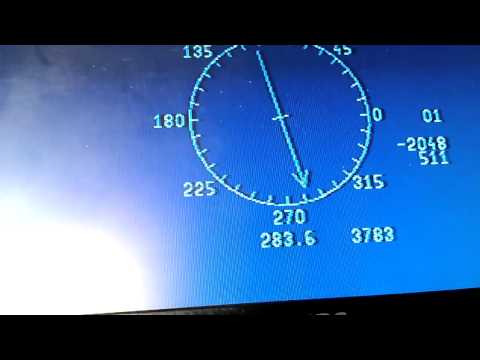

I'm building a weather station and would like to add a simple direction needle for the wind. I have a 16 point pole mounted sensor but sometimes, rather than reading the cardinal points, a simple needle would be nice. I've looked at the graphics object and a demo but to me it seems very complicated. Might there be another way? Else I need a little help!

  • RaymanRayman Posts: 16,228
    You can make a graphics area that is smaller than full screen (to save memory).
    Then, just draw a line using graphics.
    You could even double buffer to avoid flicker.

  • I'm getting closer. I can draw a line but am having trouble making it easy to get to and since I haven't programmed lately, I've forgotten a lot of what I once knew. I keep looking at the codes you've sent and some is coming back but slowly!
    Thanks
    Aaron
    What bits are you having problems with?
    Hint: Post the part of the code.
  • Cluso99 wrote: »
    I can draw a single line by ( gr.line (50,50) '' Draw a line to point " )
    but can't figure out how to use the info from weather vane (16 points) to automatically change the angle of line. I've tried some of your code (and modified parts of it) but may not have the correct formula.

    IIRC I setup the points for the hands and then drew the lines between these coordinates. I set a table for these.
    So you would need a table of the 16 points.
    You could use the minutes or seconds. Basically you would need the points for 0, 15, 30, 45 for N E S W, then 7.5, 22.5, 37.5, 52.5 for NE SE SW NE. To divide again you get 3.75, 11.25, etc.
    Now, to get approximately there, use 0, 4, 8, 12, 15, 18, 22, 26, 30, etc.
    Once you get this working, to get the actual 3.75 minute intervals (22.5 degrees) use SINE mathematics. IIRC I used an excel spreadsheet to pre-calculate the coordinates.

  • Something like this is probably what you want. Unfortunately I don't have the source code anymore and it's been nearly 4 years since I have programmed anything on the Propeller.
    It isn't really complex though...
    1) Pick a Degree point you want to represent (0 to 360) and the radius (how far you want that point from center) ... plug that into the Coordic routine to determine the X and Y for that location. This defines the tip of the arrow
    2) Pick two other points that are +5 Deg and -5 Deg from the degree point and a radius that is slightly smaller ... use the coordic routine as in step 1 to obtain the other two X and Y points. This forms the sides of your arrow.
    3) Connect your points with the graphics line function and that's all.
    4) To extend the needle in the opposite direction, follow step 1 but choose a Deg value that is 180 Deg away from your DEG point.
