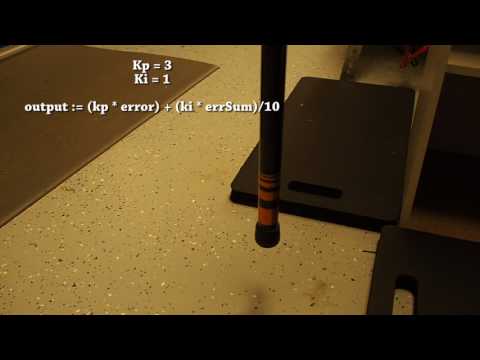

I have been able to spend several hours working on coding the hexapod. I decided to experiment with the PID loop for the coxa by re-writing a new PID routine and making it even simpler. I got rid of the existing speed control code and only used the inherent ramping on the PID. Actually its a PI loop right now, I haven't added a derivative process yet. The proportional code was easy to integrate as it is simply the constant (kp) times the error (kp*error). I determined the kp value by simply incrementing it by 1 and then commanding a move. The larger the value the faster the leg moved until I got a value where the leg had significant overshoot. Then I backed the value back down to the previous value.
The Integral portion is trickier but it improves the response rate as its output is added to the output of the Proportional code. The Integral value is based on the change in error over time, since the code time interval was essentially constant, I did not use any code to determine time. This simplifies the code to accumulating the error (errorsum = error + error sum) and then multiplying it by a constant (ki) (ki * errorsum). This value can grow pretty quickly so I put limits on its growth to prevent it going too far. Initial tuning of the Integral portion didn't go well as I was using integers for ki which cause the motor speed to accelerate much too rapidly and caused wide overshoots. That's when I figured out the ki value should be less than 1. Since I can't use floating point math (no cogs available to run the code), I set ki = 5 and then divided the integral result by 10. This produced a controllable leg movement that did not have any overshoot.
A byproduct of this testing was that the encoder value at the end of one motor command now closely matched the last encoder value for the previous command. As I stated a few days ago I ran into issues where although the stop motor command was sent at the right time, the motor inertia caused enough additional movement that the leg would end up further away from the desired position.
At this time I don't think I need to add the derivative portion of the control, I still have more testing to perform and I want to try a variety of integral constants to see what value gives the best response.
The re-write of the Coxa PID loop was successful so the Tibia and Femur loops were also updated using the new routine. This greatly simplified the movement routines, the troubleshooting text output is a significant part of the code now. With this last change I eliminated the 'S-curve' speed control as the PID now controls the motor speed. The ADC control was also removed, however I will need the ADC eventually for the leg impact sensors. Here is an example of the code used for the Coxa PID routine:

I spent a day working on just tuning the 3 PID loops, so far the leg motor output looks good when I manually input commands even with 0.1 degree movements. The Coxa encoder mechanical setup is still not the best, I see some 'sticking' of the encoder while the motor is moving which throws the position off. I want to return to the mechanical attachments and see how those can be improved.

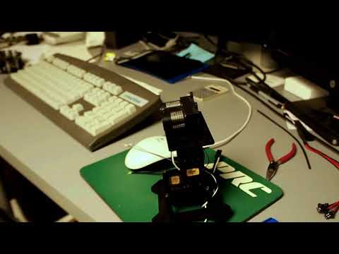

Since we are into a new year I thought I'd do an overview video of the project to bring everybody up to date on the design and current status of the robot. It doesn't cover everything but it goes over the basics.
Now back to the boring testing routines and slowly tweaking the motor PID software. I still need to get the Tibia oscillations figured out as that is the last obstacle to getting the tripod gait routine finished up.
It’s been a busy few days of work and I finally fixed the Tibia oscillation during gait movement! The fix ended up being adding a 50msec delay in the leg controller PID main loop whenever the master controller is providing the input signal. I was never able to reproduce the oscillations when I manually controlled the leg movement so looking at the difference between the code during manual vs external commands was the PST debugging output is active during manual operation and bypassed during external operations. I added a short delay so that when the debugging is disabled the loop timing would be similar as when in manual mode. And it worked!
Now the gait step is very linear and I can change the X and Z axis values manually to get the leg to move in different directions. With the smoother movement I was also able to determine that the Femur movement to lift and lower the leg at the beginning and end of the gait step has a minor overshoot that needs correcting but this isn’t a critical issue at this time.
Next step is adding the transmitter back into the loop so I can dynamically control the X and Z movements via the joystick. I started coding this but it isn’t working quite as expected yet. I think I have some incorrect assumptions that I need to review before I change any more code.
Once the transmitter is working I will add another leg controller to the testing and work on getting two legs to synchronize their movements. Of course this means enabling another serial port on the master so I can start getting used to using the 4 port serial transmission code from the OBEX.
