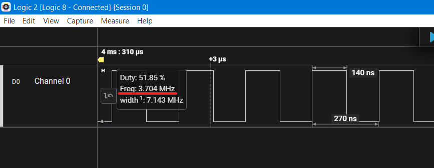

    I'm trying to generate a 3.7 MHz clock on a P2 SmartPin, for an external device.
    This works -- but I may be missing something
      freq := 3_700_000
      pinstart(TEST_PIN, p_nco_freq | p_oe, 1, freq frac clkfreq)
    Here's the logic analyzer capture:
    My P2 projects run at 200MHz.
    Edit: I just noticed that you're running at 142_848_000. The smart pin code above still produces the correct output. Hat tip to @Ariba to showing me how to use the smart pin to generate a specific frequency using NCO mode.
