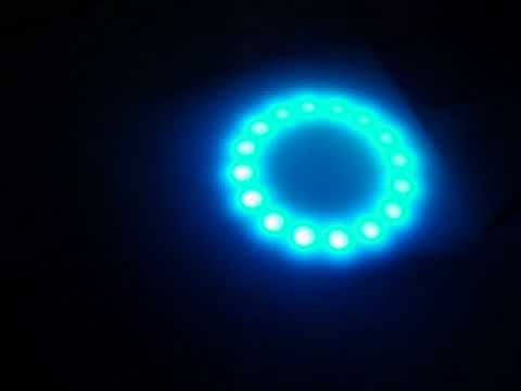

  • Rewrote code of NeoPixelRing.

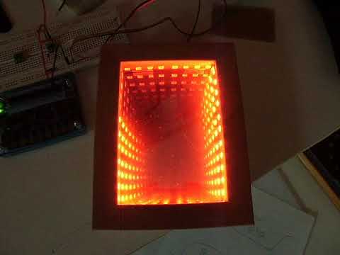

  • Rewrote code of inifinityLED.
    Actually almost same code as NeoPixelRing.
