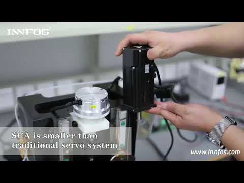

  • Ah, yeah but I believe that those are the low-end units. I think the robot is only intended for training.
