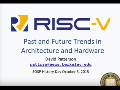

    It's interesting to hear Dave Patterson (of RISC fame) talk of the last 30 or 40 years of computer architecture history:
