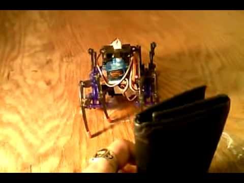

    Welcome to the forums, Steve! I made a similar routine that appears to track you. Just make the head servo oscillate constantly while checking your PING distance sensor. When you get a reading closer than X feet (your choice), stop the head. Once the person moves, resume scanning from the last position. You have a 50% chance of scanning in the right direction (left-right or right-left). If you get it wrong, it will catch the person on the next oscillation. Works pretty well for how simple it is.
    Also, I'll remind people before Halloween that a simple TV IR remote control works great outdoors at night. Second video shows my IR-triggered routine.
