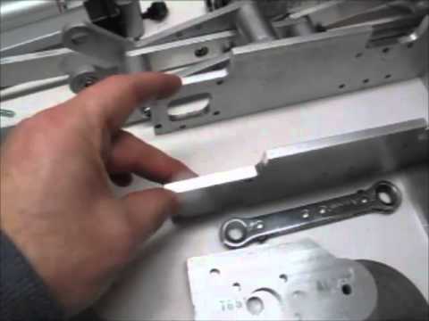

    Its been a busy few days working on the gear train setup. I got all the CAD files created and milled out the initial version. As expected there were a few problems to feed back into the design. I videoed the fabrication of version 2 on some scrap aluminum and have posted it here. There are still a couple of minor changes to make, mainly dealing with the setup of the optical encoder disk and circuit board. I have to make some more CAD changes and then its off to the CNC machine again.
    I'm pleased with the gear train result so far, the speed is down to a reasonable level and the torque appears to be adequate. The test version of the gear train is made using nylon gears primarily for cost savings until the design is finalized. Then I will swap out nylon for steel or brass gears instead. The real goal will be to create my own gears later since the steel and brass gears run anywhere from $15-$35 apiece and I'll need a lot of them! I hope to get a CNC rotary table for the mill later this spring but in the meantime this setup will be adequate for testing.
    One thing is for sure, don't go into trying to design your own robot from scratch unless you have a lot of patience, time to spare and extra cash on hand! The right tools is another biggie! You definitely won't be saving any money over purchasing a kit. I won't recommend going this route, especially for the size I'm creating unless you are able to see it through. Luckily I have most of the tooling needed and the experience from an earlier attempt at a large hexapod. The big difference this time is that I have much better tools, more experience and can afford to not take the shortcuts that ultimately doomed the first version. So far the new design doesn't have any of the issues that stopped me from finishing the original. That's not to say there won't be some issues coming up, but mechanically this version is pretty sound. The swing motor setup was one of the last issues that stumped me the last time, I think it's been licked this go round!
    [video=youtube_share;9Rv1Gr12z8E]
    The next mechanical item I have on my list is putting together the housing for the upper leg. The force sensors will be mounted in this assembly so the controller can sense when the leg tip is solidly on the ground and also sense when the leg touches something when swinging or extending. These sensors are very important in the program design so its critical to have them work reliably.
    Bob

    I started this build for the challenge and I've gotten a lot of challenges so far! I'll have to take a photo of the rejects bin, all the aluminum pieces that didn't work out as expected. I've built several wheeled robots and one with tracks but i wanted something to climb stairs and travel rough terrain.
    I've been a fan of the Odex design since I first saw it in Robotics Age magazine and have tried to create a smaller version several times. After I got my first metal lathe and mill I started a large version but it wasn't sound mechanically and had too many issues to resolve at the time and I couldn't afford the needed rework. It's been a few years since then and I have a lot more experience both in mechanical design and electronics. I was able to write down each of the original issues with the original robot and then worked a solution for each problem. Once I completed that process I realized that it just might be possible to make my version work! Odex had a team of engineers and a large budget, I have just me, whatever money the wife will let me spend. My version is between 1/3 to 1/2 size of the original but it's still the biggest robot I've ever built. This is not meant to be a copy but a similar design in that it also uses pantograph elements to amplify the leg movements.
    Time to get into the shop and work on the swing motor limit switch assembly. I've got a few ideas but will need to take some detailed measurements before I commit myself.
    Bob
