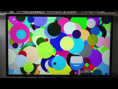

    Added high level graphics functions: line, box, frame, circle and filled circle. Written in Spin, slow, but working.
