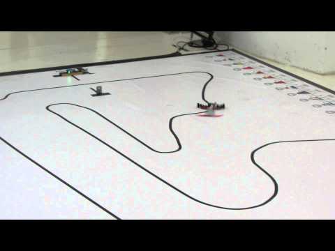

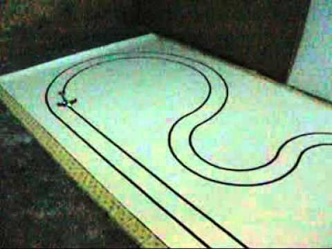

    I've seen a lot of dirt cheap line followers that are super fast.
    But, I've also been in a competition at Parallax where there were junctions and they only told you which path to choose right before the race. So, all of those would fail horribly...
    Lots of serious competition out there!
  • RaymanRayman Posts: 16,421
    Like, I said, none of those has junctions, right? Bot only needs brains when it hits an X or T junction...

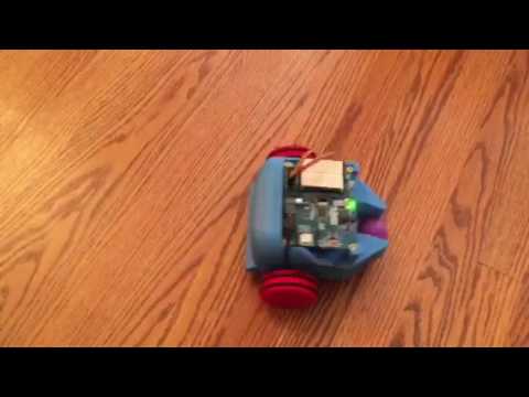

    Just tested it on driveway.. It works!
    Had to rotate the board 180 degrees though so could access USB port...

    Ok, I made a lame, one minute attempt at a figure 8...
    Modedit: YouTube link

    Does this work:
    https://youtube.com/watch?v=r25Xge8_asM
    Not lame, that's a great 8 with straight center segments, much fancier than most. You just need to get a sledgehammer and knock that wall out of the way.
    Or maybe just start farther from the wall. :)
    Great job!
