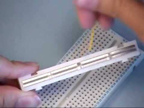

How do you place this on breadboard?
If I put it on bottom right the 2 pair of 2pin headers on bottom seem to
be a grounding hazard.
It's a Parallax medium breadboard. 660 tie point as far as I can tell. Kind of an oddball size.
Thanks!

    This breadboard.
    https://www.parallax.com/product/700-00078
    When you put power pins in side power rail the
    pins end up in the IC 'ditch'.
    When you hang it off side (signal pins in far right column) the
    power pins are just out there.
    You would have to connect 2 pin extension cable from bottom.
    Thanks!
  • Infernal Machine
  • Publison
    P24 does not line up on breadboard with power connectors
    in power rail. Period.
    Get it done solution is to use two breadboards.
    One for I/O pins and one for power output.
    Board can actually just be tested on top of anti-static bag.
    I want to protect it though.
