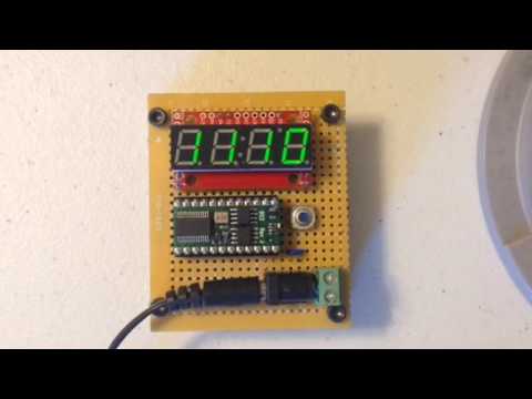

A fun exercise using the RANDOM instruction.
The Sparkfun Serial LCD four 7 segment display is used to represent the "race track" and each digit to represent a "race horse".
To generate a random number to advance the decimal digits or the "horses" 0 through 9. The first "horse" to reach 9 wins the race.
The race can be started with a button press, or to start a new race automatically. Change modes by "press and holding"
the button at the end of the race, hold in for about five to seven seconds.

Minimal Parts: Really easy to prototype and/or build.

Material Used:
BS2 Basic Stamp
24 pin dip socket
2.1 power jack
two pole screw terminal - for battery or other external source
mini pcb (0.1) mount normally open push button switch
.1 spaced perf board
4 x 32 machine screws and nuts
Power supply: 6-9 volts dc.
2 - 10k ohm resistors
small pcb mount single pole, single throw slide switch - not yet installed. To be used as a power on - off switch.
- refer to the picture, just below the button is a jumper wire, that space is reserved for the slide switch.
(I did not have one in my parts drawer, I will have order one with my next project list from Jameco, or Mouser, etc...)
No separate voltage regulator required!
The voltage regulator on board the Basic Stamp 2 has enough capacity to supply the Sparkfun Serial LCD four 7 segment display.
